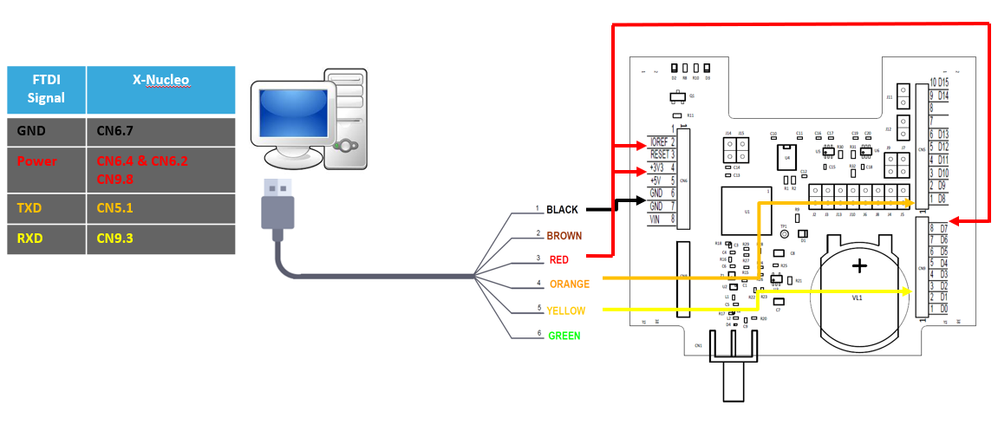

Francesco Virlinzi
Hi
I understood you are using the X-NUCLEO-GNSS1A1 directly with the FTDI UART2USB (at the end without any STM32 Host).
In this case I think the Level-shifter on the board are not correctly configured.
Could you test on teseo-Suite if using the command '$PSMTSRR' can reset the X-Nucleo board.
If not this means the LIV3F is not receiving the Input stream and due to that you can not change the configuration
Regards
 Francesco
This is the FTDI UART2USB connection you should use
Regards
 Francesco
This command does not reset the X-Nucleo board. I have wired the FTDI's VCC to IOREF, 3v3, and RESET (D7), as you showed in the schematic, but I am still unable to transmit to the LIV3F.
 I am including a picture of how I have the board wired, perhaps there is something noticeably wrong :grinning_face_with_sweat: I tried moving around the jumpers to use the other UART connection (C9.1, C9.2), and was able to receive the NMEA strings, but not able to send any settings to the LIV3F.
