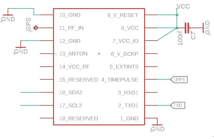

So looking at my PCB schematic,I do not use this filtering at all. Also...my antenna is simply a 45mm length of wire directly connected to PCB from Pin 11.
Notice I do not have Pin 6 connected...I may also connect that to VCC like figure 12 is showing.
I need to find proper cap/choke values yet. Not sure if I need the additional circuitry for antenna? Looks I will need to reinvent the PCB to use this module.
For only 4 bucks each,maybe easier and wise to just use the Chinese modules I have been using that work fine on my existing PCB. Not saying the Tesio is a bad module,just not feasible for my current design and purpose.Just an FYI... I build and float these small circuits around the earth on balloons which are tracked using a network already in place. But since I already have this module,will see about using it for my test gear in which I can use a GPS for it anyhow.

Hi
In the module @ https://www.aliexpress.com/item/GP-02-GPRS-Series-GPS-BDS-Compass-ATGM336H-Satellite-Positioning-Timing-Module-GP02-PCB-IOT-Artificial/32831293547.html?spm=a2g0s.9042311.0.0.13394c4dFIl0xu
the pins#7 is declare 'NC' while for Teseo-LIV3F it is the VCC_IO this means 3.3V has to be there to guarantee a correct IO managements.
