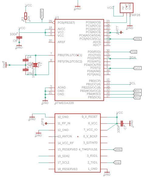

Sort of a bummer...I was hoping it would work in my current circuit as is.Maybe it does not pay to get things fast...now have to wait longer for the proper GPS.
This is my schematic using Ublox and generic which work perfectly fine.May be too small to see,but basically GPS wired to Atmega 328p-au using one cap at v3.3v .

Francesco Virlinzi
Ciao
> is this TESEO-LIV3F compatible to replace the other GPS modules I have mentioned
Yes . It is.
Do you see the PPS pins toggling?
Uart.Tx boardrate is @ 9600
Regards
