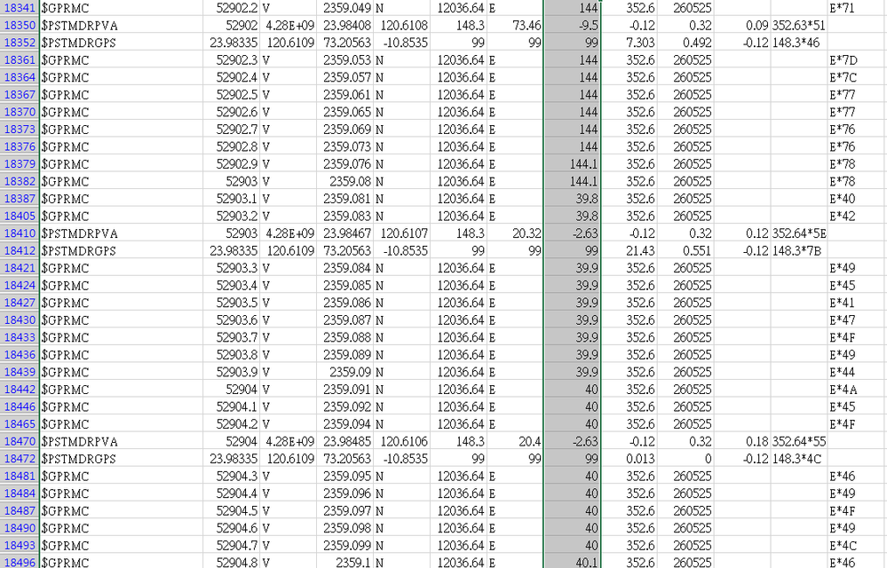

Regarding log, it was my mistake, when filtering the data I accidentally pasted the wrong column in my comparison.
So I had a chance to look at your data, the speed output and also the accelerometer output.
As indicated during the time when DR showed a speed of 0, the accelerometer also was showing ~0 values indicating the vehicle was not in motion.
I discussed this our R&D team and they indicated couple of considerations,
1. You mentioned you calibrate this in a car and then put the calibrated unit on a train. In this specific case for your testing, the calibration values were almost similar when placed in a car and train, therefore VIC3DA worked. However we cannot guarantee this will be the case for all units that is calibrated in such a way. This can result in some units in the field not being calibrated.
2. VIC3DA is primarily intended for automobile applications and not really for train. The vibrations of a train will be different than a car and this could be the reason why VIC3DA misinterpreted the speed value.
I have forwarded your case to your marketing team. Meanwhile, can you also please get in touch with your local ST sales/distributor team and initiate discussion. They can guide with the right solution.
Attached is result of my analysis for your reference. You can refer to timestamp of ~52900.
