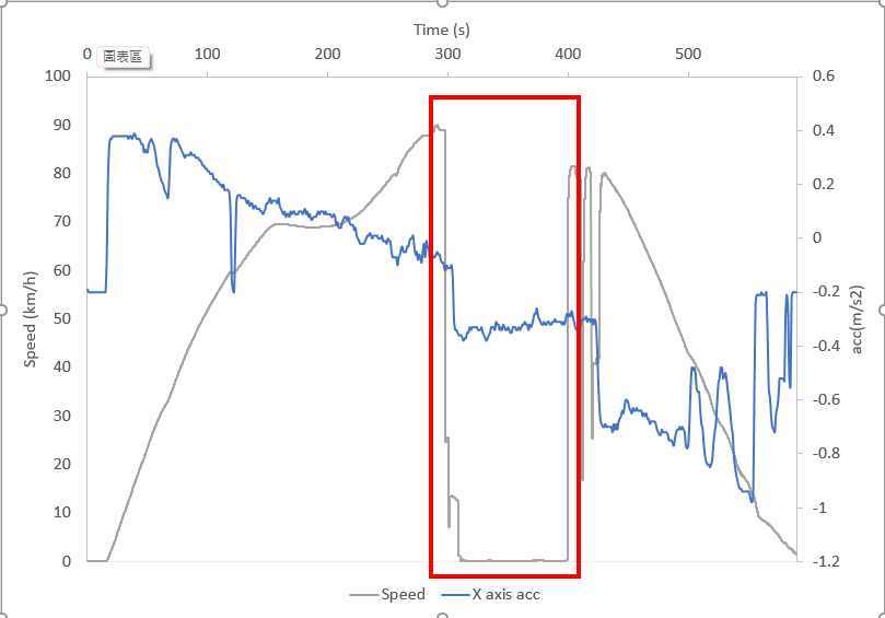

But sometimes the speed estimated by DR would suddenly drop to 0 after I entered the tunnel (and the actual speed was around 80-90 km/h). The flag from PSTMDR2 was still "CC". Seems the DR mode was still working, but it give the wrong data.
Speed data and X axis acc data are the following: (red box is the data when I entered the tunnel)螢幕擷取畫面 2025-05-29 112421.png
I had placed the VIC3DA on a heavy steel plate and tight it with seat belt. It may not have relative movement.
Are there someting I misunderstood?

Could you please let me know what $PSTMDRPVA reports when speed drops to 0?

Sorry. Previously, the data was modified to avoid violating confidentiality agreements with my work partners. Now that the matter has been clarified, please consider the following data as the accurate reference.
We have collabrate with a railway company. They want to get the accurate position of trains by GPS&DR even if the train is in the tunnel. So we chose VIC3DA to do that.
Because the route of the railway doesn't meet the requirement of AN5678, we trained DR with another car and put VIC3DA on a steel plate with horizontal adjustment. And we moved the steel plate on the train, did horizontal adjustment, trying to simulate the situation in the car.
Although the "CC" flag in PSTMDR2 is still there when the train entered the tunnel, but DR seems not working. Is that we need to adjust the setup more accurate? Or are there some better way to get accurate position in the tunnel, or using DR easily?

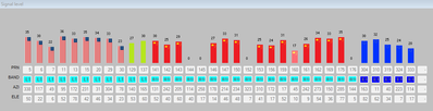

In addition to my above message, could you please let me know how the antenna is placed?
The reason I am saying is during the initial part of the run when you are in open sky, the signal levels are not that great. In open sky, you would except CN0 of the signals to be ~45 db-Hz while most of your signals are in 30s and 20s.
