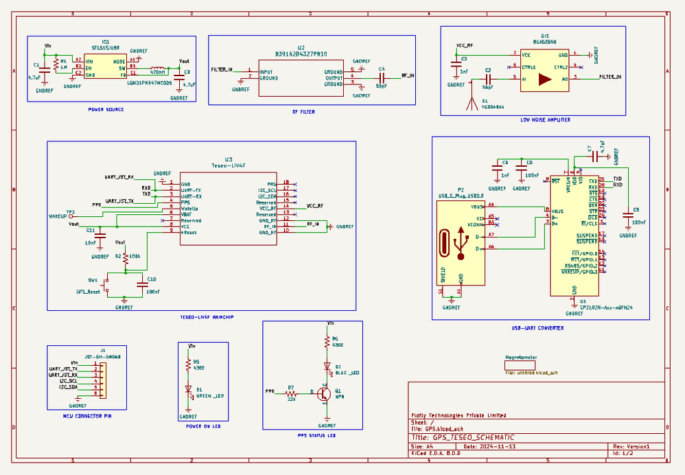

i have built a custom gnss application for my UAV, using the teseo liv 4f module.

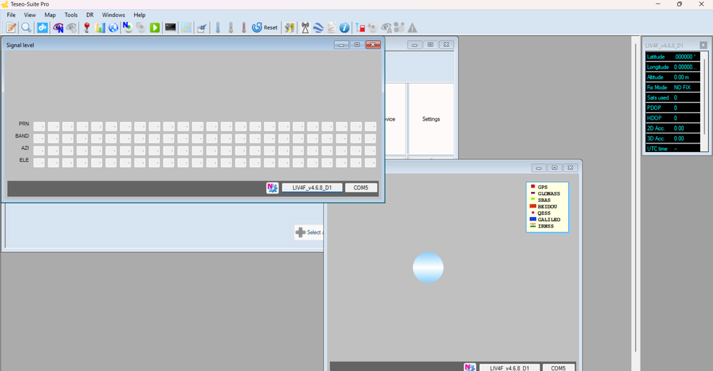

i have attached my circuit herewith, and also the corresponding output from the teseo suite.
The module has no fix always and is not locking onto any sat.
please look into my circuit and let me know the issue.
I have used a taoglass active antenna(Acurra GNSS) for the circuit.
2025-03-03 9:43 AM - edited 2025-03-03 10:11 AM
Active antenna not powered?
b39162b4327p810 https://www.mouser.com/datasheet/2/842/Qualcomm_B4327-3464328.pdf
2025-03-03 9:47 AM
Small correction it's a passive antenna
