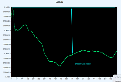

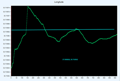

Thanks for the answer I understand, I upgrade firmware and try get accurate position and made some test in teseo suite program. I have this antenna on this link:
I activated GPS,GLONASS,GALILEO and QZSS and observed latitude and longtitude values on teseo suite chart. charts like below. I also added on the image real values which are blue lines: the values seemed a bit strange to me, quite far from the expected CEP values. What can be the reason, in a nutshell what should I do increase accuracy. I will be waiting for your recommendations.
Last question, If I increase fix rate from 1 sec to 5 sec, would this change affect the accuracy of positioning ?

Have you used a tool to visualize the spread of your points? Checkout a tool called NMEASTAT, you can upload your NMEA data and you can visualize your data. We are enabling this feature in TeseoSuite in an upcoming release.
Meanwhile on Teseo Toolbar, there is a "View Positioning" icon. You can enter your reference position and the tool will calculate CEP-50 values.
I used the distance between the maximum latitude difference and maximum longitude difference to determine spread of 2 points and the value I calculated is ~ 2m which is CEP-95 or CEP-99 measure. I know these points of the maximum variance that I used did not happen at the same time so your spread of fixes is smaller than that.
To get most optimal performance / GNSS accuracy make sure you have clear view of sky and no chance of multipath. Increasing fix rate from 1 sec to 0.5 sec is not going to increase accuracy by GNSS but you can use statistical means to ascertain accuracy since you have more data points.
