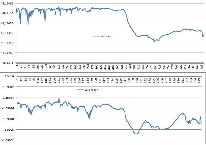

So with the GNSS on the car roof on a parking and a test on 15mn I have a CEP of 2.3m.
Do you have advices to improve this?
As you can see sudenly latitude and longitude changed despite the GNSS did not moved...
