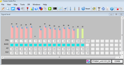

The teseo GNSS is outside, on the roof of the car.
I linked the Teseo GNSS to your Teseo-Suite Pro tool.
I requested the configuration with your Teseo Suite and the result is :
$$PSTMSETPAR,1227,0xbc0003d5*06
But as shown, your teseo GNSS can only see GPS satellites:
How is it possible that only GPS satellites are seen?
Is there any other configuration to check?
Once again, previously to this firmware update, GGA messages were GNGGA and not GPGGA only..
I attached the log file with the GSV messages.
Best regards.
