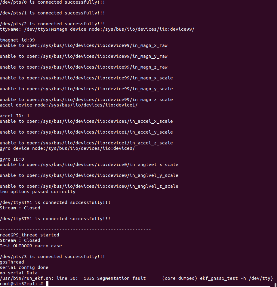

We tried creating an image using the optee and fastboot folders. The STM board successfully booted, but when ./run_ekf.sh is executed, segmentation fault error is encountered.
I’ve also attached a screenshot of the error message for your reference.
Could you please help us resolve this issue?

Hi Sharat,
In logs we can see application unable to find accelerometer, magnetometer and gyro nodes.
Just a query did you integrated GNSS1 package software, perhaps you can go through UM2909 regarding how to build and integrate drivers for IMU.
segmentation fault issue is due to a missed check which will be fixed in upcoming releases, but it's happening due to the reason that no IMU sensors node are found due to IMU drivers not integrated.

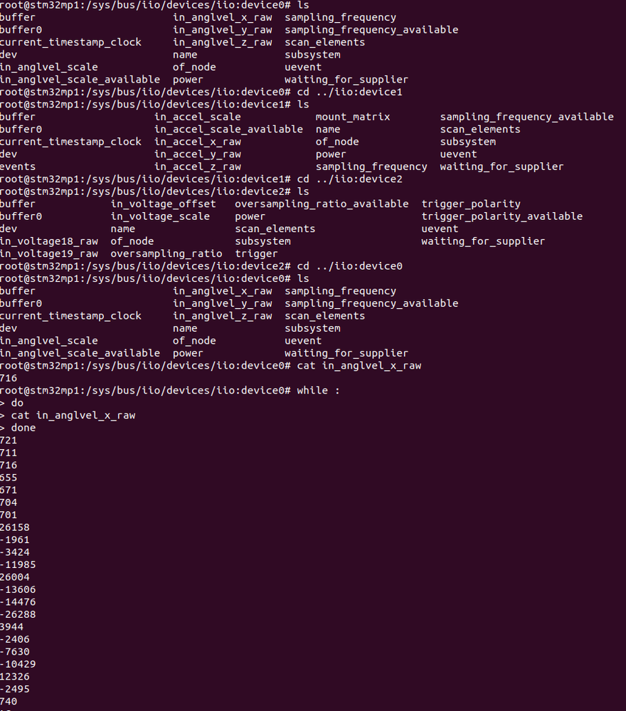

I noticed something interesting. When I navigate to /sys/bus/iio/devices/iio, I see iio:device0, iio:device1, iio:device2, and iio:device3. Inside iio:device0, there are files like in_anglvel_x_raw, in_anglvel_y_raw, and in_anglvel_z_raw. Running cat in_anglvel_x_raw shows the raw ADC values, which change when the STM32MP controller module moves.
In the run_ekf.sh script, line 50 has a binary command ekf_gnss1_test, but it throws a segmentation fault as you have noticed from my previous post.
I've integrated the gnss1 package software and reviewed UM2909 on building and integrating drivers. Could you help me troubleshoot this issue? I’ve attached screenshots for your reference.

new version of GNSS package is on web and github, where this issue is fixed. can you please help to validate
Hi Sharat, one of the customers tried and gave feedback that it's working. please test on latest version.
