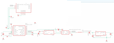

I just designed a pcb with LIV3F module. I tried to follow layout instructions but I'm not RF expert. I can read through the USART bus but every values (GPGGA, GPVTG, etc.) are set to 0, as if there is no input RF signal.
Herein below schematic design and my Eagle files, hope someone could point out what mistake I did?

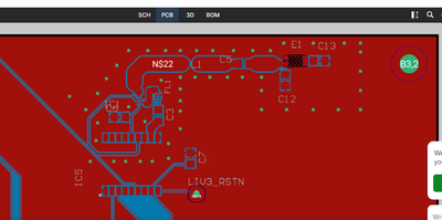

Looking at the antenna datasheet, could you confirm if you have followed the guidelines mentioned in page.2 of the attached document -  the antenna datasheet.
Eg: there are ground vias between the antenna and the edge of the board.

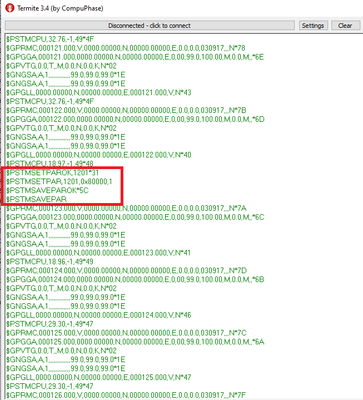

You can enable GSV messages in the register settings by the following command,
$PSTMSETPAR,1201, 0x80000,1
$PSTMSAVEPAR
$PSTMSRR
There are indeed ground vias between the chip antenna and the board's edge (see below)
Il also tried replacing ceramic antenna by patch and screw mount SMA antennas with no effect...

BTW, I tried enabling GSV messages, commands seem to be acknowledged (see below), but no xxGSV messages are showing up
