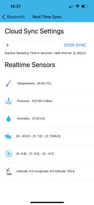

Hello
FP-ATR-ASTRA1  - platform STEVAL-ASTRA1B, Teseo-LIV3F GNSS module
Outdoor GPS  not working, Requesting  help to fix this.
latitude: 0.0, longitude: 0.0,  altitude: 100.0
Thank You
Sudhir

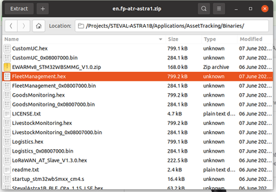

My team also have same issue on this. We would like to try updating ASTRA-1B firmware. We download the firmware zip file from the STEVAL-ASTRA1B product page. Under tools & software tab and under MCU and MPU embedded software section. I download version 2.0.1
After for quite sometimes searching for the firmware. I stumble upon this binaries folder. Which I believe the firmware for STEVAL-ASTRA1B. Is this the firmware that i suppose to upload to STEVAL-ASTRA1B?
This is the firmware binary that needs to be programmed.
en.fp-atr-astra1\Projects\STEVAL-ASTRA1B\Applications\AssetTracking\Binaries
Thanks,
George

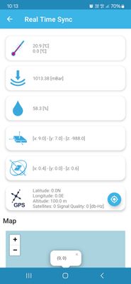

Hi galaxyquest,
I also face the exactly same issue as technofreaks,
My gnss also not receiving any signal from satellites,
I also tried to test it outside with a clear sky view,
And I also programmed the binary (2.0.1 Livestockmonitoring) from the folder.
It didn't fix the issue.
i uploaded a screenshot from the app,
Thank you
