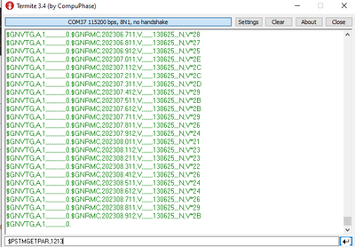

This worked to limit the messages to only those, but now there is not a new line between each VTG and RMC message. The new line only comes after both messages are received as shown by the following image of my terminal viewer.
Any help to get the new line to send between each message is appreciated!

I checked with our app engineers and this is a bug in the module firmware for this message list combination. I was also able to reproduce this.
Is CR/LF used to check end of NMEA sentence ? Instead of CR LF to end of NMEA, can you use "$" to detect the start of next NMEA sentence?
I use the new line to check for the end of the incoming NMEA message. That could be an alternative route we could investigate. Thanks!
