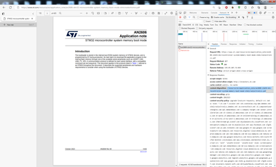

2023-11-28 2:47 PM
Again this misrepresenting and toning down of the issue... This particular problem is not a problem of the web browsers, but a bug in the main ST web server, which outputs a nonsense in the value field of the particular HTTP response header. Anyone can view it in any browser by opening the URL with PDF, pressing Ctrl+Shift+I and reloading a page with Ctrl+F5. Here is an example with Edge:
Look at the documentation, to which I already gave a link, and then look at what your web server returns!
