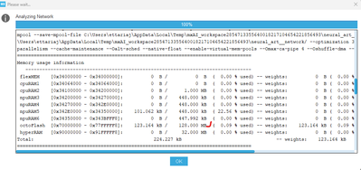

I am using the STM32N6570-DK board to run AI model on it. And I have modified the stm32n6.mpool file because the board actually have a 1‑Gbit Octo‑SPI flash memory, which is 128MB instead of 64MB. But even if I have already adjusted it, the cubemx still shows "Used Flash:3.51MB(.00B over 64.00 MiB xSPI2)". Is there a problem and how I can fix it? By the way, I want to know that where I can get some examples about using AI on the STM32N6570-DK board, and the correct way to modify the files so that I can use the external memory on the board.

I think it is only a interface issue, when you do a validate, here is what I get:

Thank you, but I still want to confirm that if I use the configuration according to the picture above, the 3.51MiB used FLASH will be stored in the external 1Gbit FLASH, right?
2025-04-24 12:29 AM
Hello @Z-YF,
Yes, I think.
I would advise you to look at the table I sent in my last message.
When you do a Analyse, you get the exact detail of the memory used.
Have a good day,
Julian
