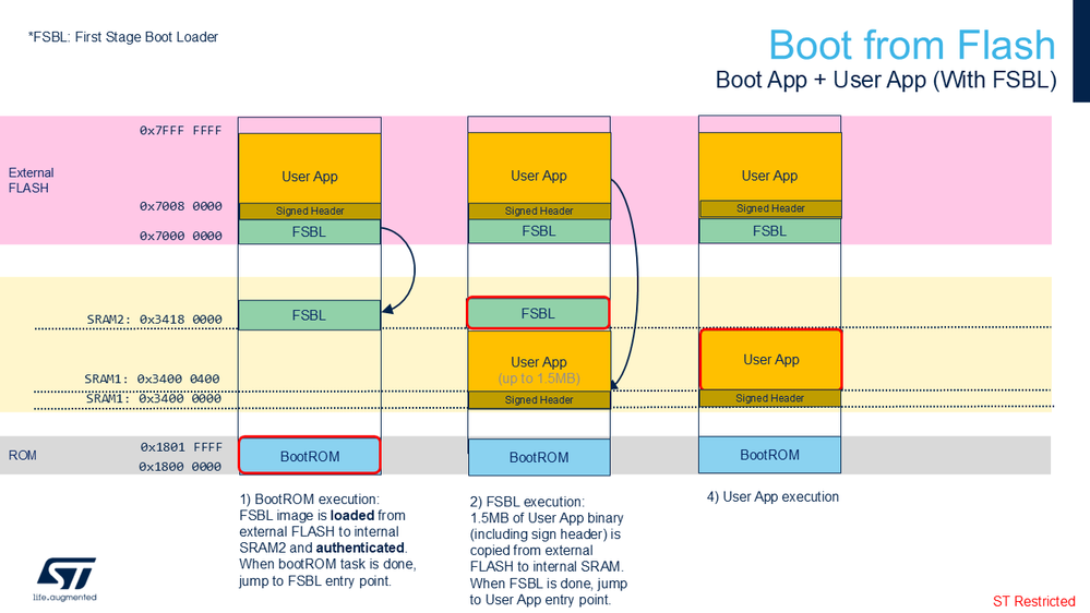

I have downloaded the official example x-cube-n6-ai-hand-landmarks-main and reviewed the DataBrief of the development board. Since the board itself does not contain internal Flash, the file _htmresc/FSBL.PNG in the example clearly indicates two possible solutions:
  1. User APP programmed into SRAM (address: 0x3400 0400 ~ 0x3418 0000)
  2. User APP programmed into external Flash (address: 0x7008 0000 ~ 0x7FFF FFFF)

I am seriously considering whether the issue might be related to the STM32N657xx.ld file. The binary files generated by the Build process in the Bash terminal seem to be located at address 0x34000000, while the official example application file (x-cube-n6-ai-hand-landmarks-dk.hex) located at address 0x70100000 as it be generated as hex file.
Therefore, I would like to ask whether it is necessary to modify the .ld file. If my problem is indeed caused by an incorrectly configured address in the linker script, I hope to receive some guidance and instructions so that I can continue and complete my subsequent research a
