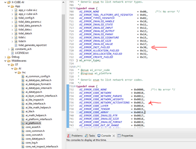

I have a trained CNN model converted to .TFlite file. The file has been analysed and validated on PC and Target. All are correct. Then an application template was developed. When I tried to run initiate CNN model with generated function " static int ai_boostrap(ai_handle *act_addr)", there is issue in this layer:
ai_bool cnn1_configure_activations(ai_network* net_ctx, constai_network_params* params) (Can not go deep anymore). Always return false. From ai_cnn1_init() returned an error type 48 and error code 19 as shown in the screenshot attached.
Would you please help me sorting out this issue?

Your errors 48 and 19 correspond to initialization errors (in middleware/st/ai/ai_platform.h)
