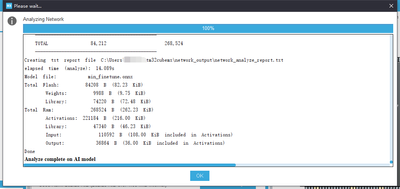

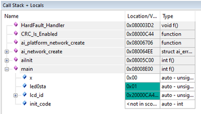

I have version 6.7.0 of STM32CUBEMX, version 8.1.0 of X-CUBE-AI, and my stm32 development board model stm32h743iit6. using the Analyze button on STM32CUBEMX works. But when I generate c code for my onnx model and deploy it to the development board, my model fails to initialize. When I traced how the problem happened, I saw the ai_platform_network_create function. It's a black box function and I can't get inside it (it seems to be an officially provided function). I can compile and burn normally using the Keil software, but I can't proceed further when I run into this function. When I use debugging and click on the Stop button while stuck, my Call stack+Locals window prompts an HardFault_handler error. How do I get my model to run properly?

The STM32Cube.AI library requires to have the CRC IP enabled.
Normally when the code is generated using STM32CubeMX and X-CUBE-AI the initialization of the CRC is done automatically. You can copy paste that part of the code in your project.

Thank you for your answer, the problem has been solved!
Thanks again!
