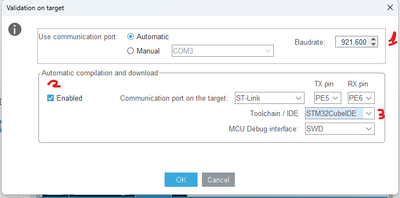

Hello @cxf,
Now that you corrected your objectcopy error, you can perform a validate on target in cubeMX.
To do so, make sure to put both pins on the right on your DK board (and reset the alimentation).
Then in cubeMX, click validate on target and use the config below:
This should work.

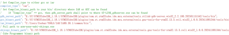

Thank you all for your help and time investment,I really appreciate it!!!
problem 1: objcopy path error
solution: by Julian E's way,i change my config.json as
and it never output this problem
