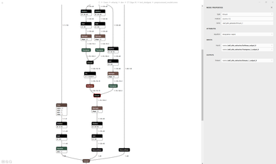

I have provided my ONNX model, which has been tested.
INTERNAL ERROR: H not found in shape with shape map (BATCH, CH, W)
