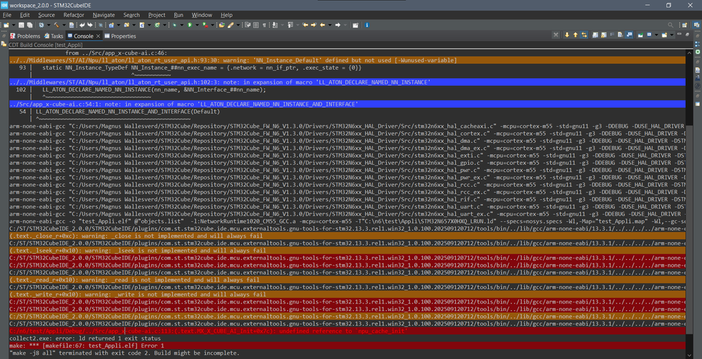

I'm trying to run a simple validation or application on the NUCLEO‑N657X0 but I can't seem to get past build errors. I don't know if it's the setup in CubeMX or what. Thanks

Hi @73Bird,
It is difficult to say like that.
What I suggest is to stop using X Cube AI. A new tool was released to replace it:
Introducing STM32CubeAI Studio - STMicroelectronics Community
With STM32CubeAI Studio, you can use the ST Edge AI Core 3.0 instead of the 2.2 (I assume).
With that, you can generate a new project that hopefully do not causes errors.
Have a good day,
