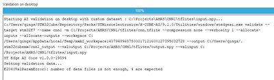

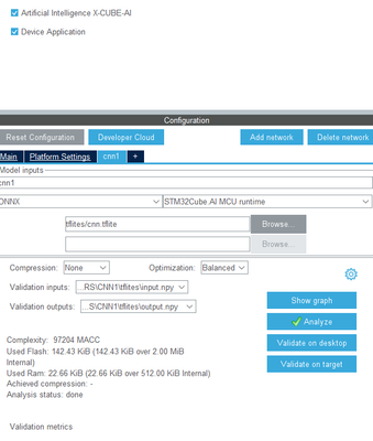

I am trying to validate a CNN on STM32CubeMX with X-Cube-AI 9.1.0. I provided a datainput.CSV and a dataoutput.csv files to "Validation inputs: & Validation outputs: " respectively. When ran Validate on desktop or Validate on target, they all failed >> "E204(ValParamError): number of data files is not enough, 4 are expected."
Could you please help me sort out this problem?
Do data files in .csv correct?
Only have 2 boxes for 2 files providing, why expected 4?

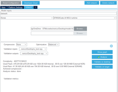

For example, let's say that I have a model with an input size of 32x32x3 (RGB images) and 5 classes. I can generate two files containing 10 examples like this:
import numpy as np
# generate random images and labels
x_test = np.random.rand(10,32,32,3)
y_test = np.random.rand(10,5)
# Save one file for the inputs, another for the outputs
np.save("x_test.npy", x_test)
np.save("y_test.npy", y_test)
Then load these files in CubeAI:

Many thanks Julian for your reply. I have changed the data files following your instruction. However, still got the same problem. I would like to upload the data files for your having a look, but here does not support the .npy format files.
Would you mind advise me trying anything else?

This is the error:
