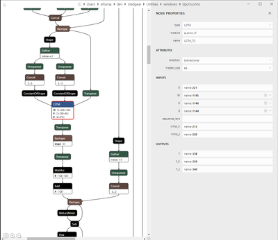

INTERNAL ERROR: Trying to remove node_339 which has multiple inputs

Hello @uveuvenouve,
The issue here is that bidirectional LSTM are not supported in ST Edge AI
You can see below that your node_339 is the bidirectional LSTM:
You can find the list of supported ONNX operator in the ONNX toolboox page in the CubeAI Documentation:

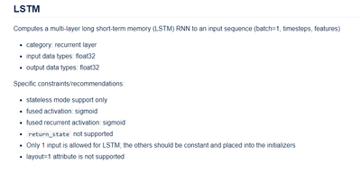

Concerning the LSTM:

Hello @uveuvenouve,

Hello @uveuvenouve,
Sadly, with the current state of the ST Edge AI Core, you can't.
If you are able to edit the model and only use supported operator, then it would work. But it probably requires a lot of work, and it will not be the same model anymore...
In the future, the people working on the ST Edge AI Core might add it, but it won't be soon sadly.
