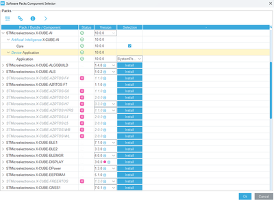

First, please install the version 10.0.0 of CubeAI as it integrates bug fixes of previous versions (always uses the last version).
Then here is what I suggest doing:
Basically, if you only want to validate your model on target (compare how the model behaves on your target), use the validation template.

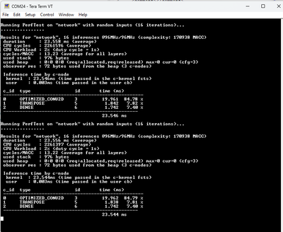

If you want an example of running application that compute the inference time of a random input and send via serial some metrics, uses the system performance template
If you want a template where the AI_run function is already in place, but you have to edit the input and output function, select the application template.
Here I will take the system performance template:
