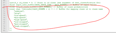

Here some sample declaration added in your main program for the use of the NanoEdge AI library.
You can directly copy this declaration or modify the names.
* WARNING: respect the size of the buffer.
uint8_t oneclass_result = 0; // Point to the result (see argument of neai_oneclass fct)
float input_user_buffer[DATA_INPUT_USER * AXIS_NUMBER]; // Buffer of input values
*/AI:How to create a current sensing classifier using NanoEdge AI Studio - stm32mcu Official examples:

Hello @michael_yang ,
It seems that you are doing N class classification, but in your code, you are using One class classification function...
enum neai_state neai_oneclass_init(const float knowledge_buffer[]);
enum neai_state neai_oneclass(float data_input[], uint8_t *is_outlier);
It works the same way in 1 class or N class, but the functions are not the same. Find the documentation here:
https://wiki.st.com/stm32mcu/wiki/AI:NanoEdge_AI_Library_for_n-class_classification_(nCC)
and concerning your issue with NanoEdgeAI.h , I am not sure to understand what you want.
In this file, at the end, you have the id2class that you can use in your code to know which class is which (0,1,2 etc)
