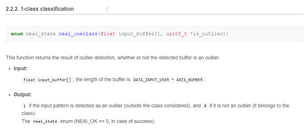

Here is the documentation about the neai_oneclass function:
https://wiki.st.com/stm32mcu/wiki/AI:NanoEdge_AI_Library_for_1-class_classification_(1CC)
As you can see, if it returns 0, it means that the library predicts that the signal is not an outlier. So, if your library output only 0, it means that the library is classifying all the signal as not an outlier.
1-class classification is a type of project made to help user without anomalies, but in practice, it is very hard to get a good model without any example of anomalies.
In certain use case, 1-class classification model can be of some help and detect some anomalies, but in other it is not helpful and cannot make the difference between normal or abnormal signals.
If you have abnormal data, please do an anomaly detection or N-class classification project.
If you don't have abnormal data, please try to obtain some, and if it is not possible, there might be no solution for you.

Indeed, in NanoEdge AI Studio, in the emulator step, the "classes" are regular and abnormal, and it should be outlier.
In the emulator that you can download, it is regular or outlier
In the library it is 0 or 1, 0 being regular and 1 outlier.
We will change abnormal to outlier in the NanoEdge AI Studio emulator.
