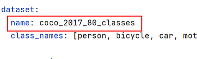

Not yet, I use food classification and image classification.
*This post has been translated from Chinese to comply with the ST Community guidelines.

Did you check your user_config.yaml file, is the name field missing?

general:
model_type: ssd_mobilenet_v2_fpnlite # 'st_ssd_mobilenet_v1', 'ssd_mobilenet_v2_fpnlite', 'tiny_yolo_v2', 'st_yolo_lc_v1', 'st_yolo_x', 'yolo_v8'
# path to a `.tflite` or `.onnx` file.
model_path: D:/stm32aibushu/stm32ai-modelzoo/object_detection/ssd_mobilenet_v2_fpnlite/ST_pretrainedmodel_public_dataset/coco_2017_80_classes/ssd_mobilenet_v2_fpnlite_100_256/ssd_mobilenet_v2_fpnlite_100_256_int8.tflite
operation_mode: deployment
dataset:
class_names: [person, bicycle, car, motorcycle, airplane, bus, train, truck, boat, traffic light, fire hydrant, stop sign, parking meter, bench, bird, cat, dog, horse, sheep, cow, elephant, bear, zebra, giraffe, backpack, umbrella, handbag, tie, suitcase, frisbee, skis, snowboard, sports ball, kite, baseball bat, baseball glove, skateboard, surfboard, tennis racket, bottle, wine glass, cup, fork, knife, spoon, bowl, banana, apple, sandwich, orange, broccoli, carrot, hot dog, pizza, donut, cake, chair, couch, potted plant, bed, dining table, toilet, tv, laptop, mouse, remote, keyboard, cell phone, microwave, oven, toaster, sink, refrigerator, book, clock, vase, scissors, teddy bear, hair drier, toothbrush]
preprocessing:
resizing:
interpolation: bilinear
aspect_ratio: crop
color_mode: rgb # rgb, bgr
postprocessing:
confidence_thresh: 0.6
NMS_thresh: 0.5
IoU_eval_thresh: 0.4
yolo_anchors: # Only applicable for YoloV2
max_detection_boxes: 10
tools:
stedgeai:
version: 10.1.0
optimization: balanced
on_cloud: False # Not Available For STM32N6
path_to_stedgeai: D:/stm32edgeai/stedgeai/2.1/Utilities/windows/stedgeai.exe
path_to_cubeIDE: D:/Stm32Cubbeide/STM32CubeIDE_1.16.0/STM32CubeIDE/stm32cubeide.exe
deployment:
c_project_path: ../application_code/object_detection/STM32N6/
IDE: GCC
verbosity: 1
hardware_setup:
serie: STM32N6
board: STM32N6570-DK
hydra:
run:
dir: ./src/experiments_outputs/${now:%Y_%m_%d_%H_%M_%S}
mlflow:
uri: ./src/experiments_outputs/mlruns
There's no shortage of it. It's mine. "D:\stm32aibushu\stm32ai-modelzoo-services-3.1.0\object_detection\src\config_file_examples\my_deployment_n6_ssd_mobilenet_v2_fpnlite_config.yaml" file.
2025-05-21
2:38 AM
- last edited on
2025-06-30
12:10 AM
by
Maxime_MARCHETT
It doesn't report an error either, it just stays at that step with no further output.
