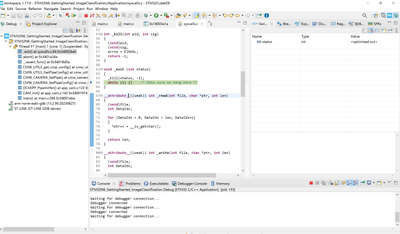

I tried to modify the class_names content [0,1,2,3,4,5,6,7,8,9] but it still didn't work. I debugged in stm32CubeIDE and it stopped at the above picture. I don't know what's going on.
