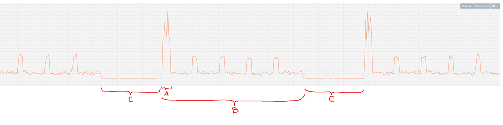

Thank you for the answer, while this clarifies it a bit I'm still slightly unsure how to interpret the results. To clarify what I mean, attached is the graph of a 5 layer model instead (still using the STedgeAI validation command with 10 samples). As you might see there are 10 clusters of 5 spikes, each spike being the activity per layer. Attached is also the report produced by the validation.
The report claims a average time per sample of 73,88ms yet when checking the graph the first spike alone seems to be around that size, as if it ignores the remaining layers (See A in the picture below). The average time per sample when including callbacks on the other hand states 1380,10ms which seems to match the time from the first spike in the 5 spike series until the end of the more noisy activity (see B below). Am I correct in assuming that B in this case is the "DEVICE duration" from the validation which only includes model related callbacks while C is the UART/USB communication, or does the "DEVICE duration" also include UART/USB communication and would therefore be a combination of B and C? If B is "DEVICE duration", would it then be more appropriate to count B as a single inference rather than A?

So, in your graph if you say A is the inference, then i would say that
For the 1380,10ms, i have to double check, but this one should be the sum of sending input tensor(s)/doing the inference -and sending intermediate data through uart-/sending the output tensor(s)

From what we can understand by comparing the report and the stpm,
Most likely, in "B" of your graph, there is the inference+UART transfers all around, but it is nearly impossible to untangle pure CPU inference time from UART transfer time because the sampling rate of the measures is way too small (i.e. you try to observe events that last 1ms by sampling one point each 10ms).
