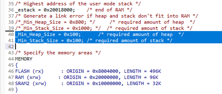

It means, that you have too many variables to fit into RAM.
Have a look at the mapfile (B-L475E-IOT01A.map) to see how RAM is occupied.

Please try to change the mininum size of heap and stack as following:
BRs,
Geunsik Lim.
