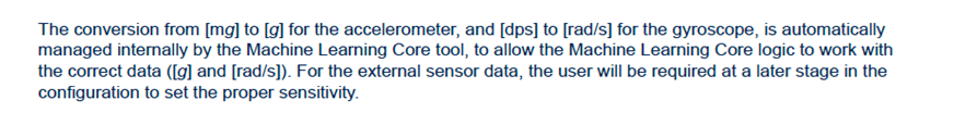

that's correct, there is a 1/1000 multiplier because the accelerometer data are converted from [mg] (the unit of measure in their standard log) into [g], according to the rule adopted by the MLC core (see the LSM6DSOX MLC app note:(

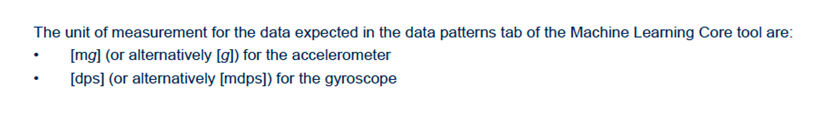

You can also find the following statements in the same application note:

Might I recommend that you please update the MLC app note to explicitly state that this conversion is occurring? I understand it is implied by the section you quoted; however, I think it would likely save others the time and confusion I have encountered.
Moreover, it is also critical to mention that the gyroscope is also scaled to entirely different units from the units of the standard log. Namely, degrees per second is converted to radians per second (multiply by pi / 180). If you could please update/edit your answer to include this fact as well, I will happily select it as the best. I would just prefer the complete answer to be in a single post for any future readers.
