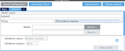

2024-05-24 12:56 PM
Dear Daniel,
For the "tensorflow lite micro runtime", is it true that there is an analyze tool in CubeMX that can help see the system performance based on tflm runtime (as shown in the below picture).
My purpose is want to debug each piece of the TFLM codes, and to see how they are working. In this case, I want to know if any ways to import TFLM library into STM32 boards and debug it.
2024-05-27 12:03 AM
In the UI, with the TFLite Micro runtime you are able to do an automatic validtion on the target that will generate, compile and flash a validation program on the target and then run the "validate" command of the tool.
With the validate command you'll get the inference time and a comparison of the inference results between the code running on the target and a python run.
You can also generate the system performance project that will display just the inference time on a serial port
Regards
