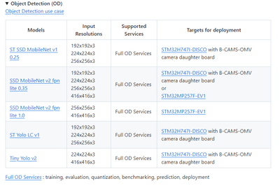

You can see that there are multiple kinds of models, with multiples input size and ready for deployment target.
For example, if you take the SSD MobileNet v2 fpn lite 0.35, you can see that in the column "target for deployment" you have your DISCO board and Camera.

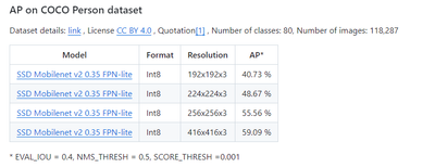

If you click on the name of the model, you get a lot of information about the model performance on one or multiple data set and in particular this:
We can see that on the COCO Person dataset (which is the same use case as in the function pack) you have different versions of the same model with different input size and performance (AP here).
If you click on one of them, you will be able to find it in the repository and you can download it.

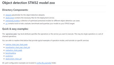

When you click on object detection, you will find the object detection specific readme:
In your case, you simply want to deploy a model, not train it, quantize it etc, so you want to click on the example: deployment, chain_qd
You want to follow this tutorial.
