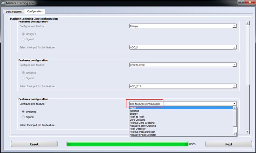

When entering Features, how do you end? There should be a "End Feature Configuration" selection but I do not see it in version 9.0.0.0. If I just "Next" another feature selection opens.
2019-07-23 7:54 PM
In menu | Configuration | Machine Learning Core configuration | Feature configurations,
"End features configuration" (or End filter configuration) would be one of the choices in the "Configure one feature:" list box.

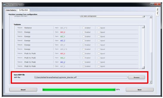

Hi @RSelt ,
to detail Winfred,s answer, please consider that in Unico 9.0.0.0. one or more computation blocks can be configured for the preliminary MLC procedure definition:
After the preliminary filter and feature configurations, the GUI will generate an ARFF file, which contains all the features computed on the input data, and the expected results and will be the input for the ML tool (e.g. Weka)

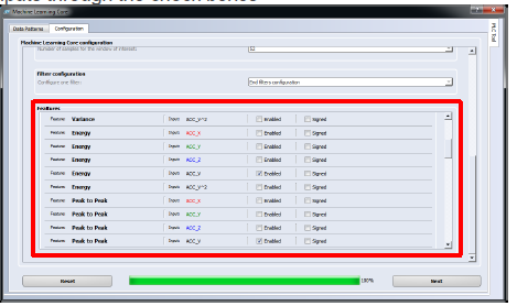

2019-07-24 3:13 AM
Eleon,
I do not get the "Save ARFF File" selection (as can be seen in the associated screenshot). If I "next" I get another "Features" selection. I just "next"ed 100 times and never got a save option. I thought that it may be a window sizing issue (hidden under the Features" selection), but the window will not resize. As can be seen by the scroll bars, the two windows are scrolled all the way to the bottom.

2019-07-24 7:06 AM
Hi Rick, I think you should enable at least one feature to proceed. Regards
2019-07-24 7:25 AM
Eleon, I have enabled ACC_Z, Mean, signed. In the previous screenshot you can see this feature above the current selection feature. ...... when you "Next" you get another Feature Entry selection option but no ARFF file save option.
2019-07-24 8:49 AM
Ok, but did you mark "Enable" or "Signed"? Previous steps are only the following:
Regards
2019-07-24 10:45 AM
Eleon,
Solved. I had selected feature: ACC_Z, Mean, signed.... but not checked the "Enable" box (as per your prior email).
