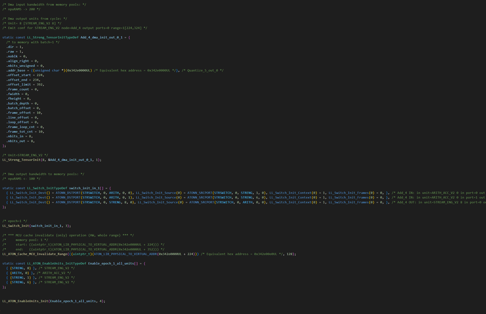

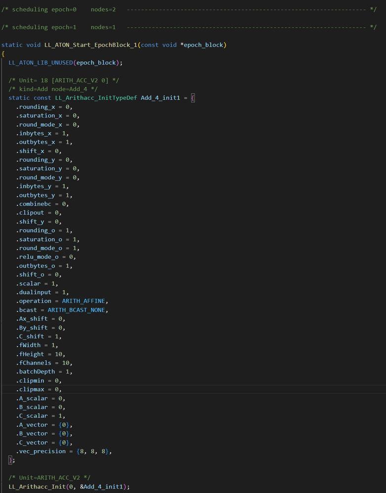

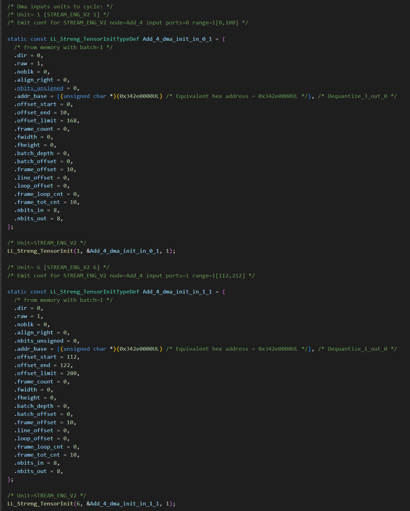

The following screenshots are taken from the network.c file generated by the STEdgeAI compiler after compiling my simple X + Y tflite model. They show the configuration of the LL_ARITHACC unit for the AFFINE operation.

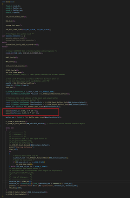

Additional information:
The screenshot (see red box in main.c) shows how I initialized the input buffer to zero before running inference. This guarantees that both X and Y are all zeros during the test. However, the problem persists: With A=1, B=0, C=0 or A=0, B=1, C=0, the outputs are still incorrect and look random.
2025-09-02 6:20 PM
Problem solved. Before starting the first epoch that passes the inputs to the NPU through DMA, I forgot to clear the D-Cache.
