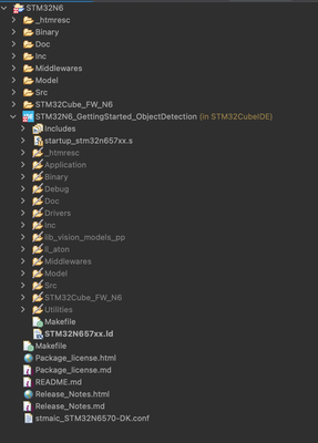

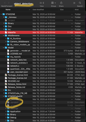

This link shows the READme that I used from the application software that I downloaded from STM32 website. I dont think I am correctly importing the project. I have double clicked the .project file and the it doesnt setup the folders for the makefile correctly. I would like to know what is the correct way to import this project. I dont know what I have to include in the "Path and Symbols" for the preferences for the project file.
"You can launch the STM32CubeIDE/.project with STM32CubeIDE. With the IDE, you can modify, build, and deploy your project on the target. To update the weights, flash them by following the instructions in the Program hex files documentation."
I am building the blue "Getting Start project file"

Hello @fazenrazen123,
The model zoo was updated. Please use the latest version.
Then go to /application_code/object_detection/STM32N6/STM32CubeIDE and double click the .project.
CubeIDE should correctly import the project and you should be able to build it with no error/warning.
Make sure to update your CubeIDE to the latest available version to avoid any potential error.
