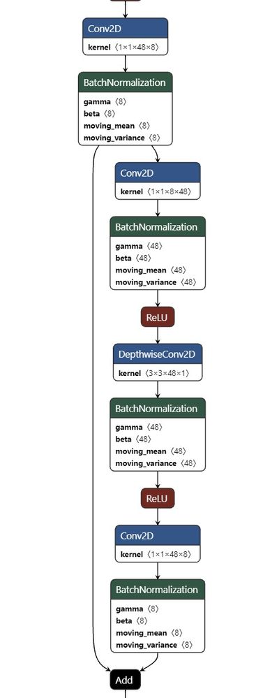

0693W00000Kcsu9QAB.pngI have a convolutional model with convolutional layers bach normalization layers and Dense layers at the end. The model is converted to a tflite model. The inferencing works perfect on computer using tflite but When I try to deploy it on the nucleo h743zi2 I get this error.
The network layers ans its shape look like it is shown in the pic. Has anyone come across this problem?

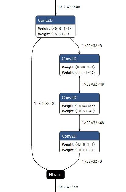

fauvarque.daniel
During code generation there is an optimization phase that can merge some layers, a typical case is a Conv2D followed by a batchNormalization followed by a ReLU, The optimized graph will just have a Conv2D
For example for this part of the model
0693W00000KdCYTQA3.jpgAfter the optimizer the model will look like
Regards
Daniel
