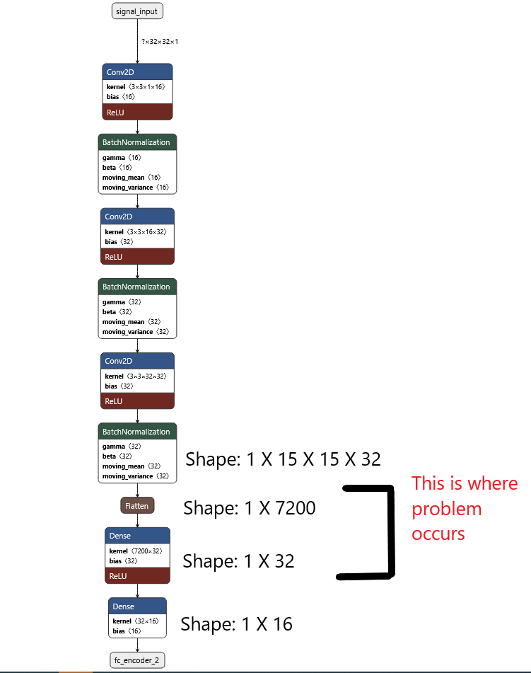

0693W00000Kcsu9QAB.pngI have a convolutional model with convolutional layers bach normalization layers and Dense layers at the end. The model is converted to a tflite model. The inferencing works perfect on computer using tflite but When I try to deploy it on the nucleo h743zi2 I get this error.
The network layers ans its shape look like it is shown in the pic. Has anyone come across this problem?
As far my understanding goes, I did not do wrong model creation. It is some bad interpretation from STM Cube library.
Additional Info: I am using STM Cube AI version 7.1.0
Thanks in advance
Rick

The problem comes from the optimization to fold the batch normalization.
With the undocumented option "--optimize.fold_batchnorm False" the model is analyzed correctly.
You can pass the option directly to the stm32ai command line or if you are using X-Cube-AI inside STM32CubeMX you can add this option in the first screen of the advanced parameter window
Regards
Daniel
Regards
Daniel
