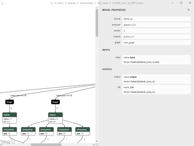

2025-08-01 2:31 AM
Hello @cxf,
So if we take the model you shared in your first message, the non quantized one, it looks like this:
(the app is netron)
You have one input of shape (2,625) and 2 outputs of shape (3,) and (1,).
Here is a script that generate npy files with 10 examples:

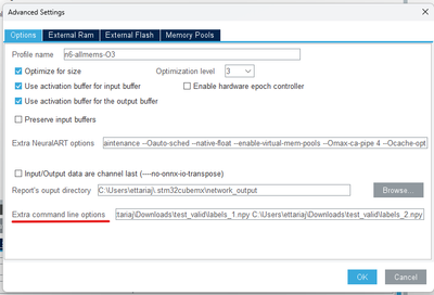

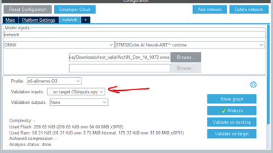

Then in STM32CubeMX, in the X Cube AI pannel:
For the output, here because you have 2 files, you cannot just use the "validation outputs" option. You need to go in the option (click the blue wheel above "show graph" on the right) and add an "Extra command line option":
the command is
-vo path_to_labels_1.npy path_to_labels_2.npy
I set the path starting at the root C:/..../labels_1.npy
Then click ok. it maybe will launch something.

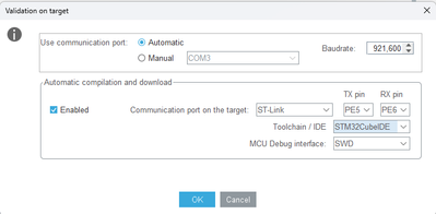

Then click on validation on target and set the right option:
and click ok.
