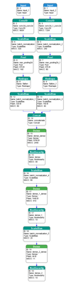

I have an ML model that consists of 2 inputs as shown in the picture. Is the code for the inputs correct?
float ML_input[WINDOW_SIZE*NUM_POINTS];
float Diff_input[WINDOW_SIZE*NUM_POINTS - NUM_POINTS];
static ai_float activations[AI_NETWORK_ADEM_DATA_ACTIVATIONS_SIZE];
static ai_float in_data[AI_NETWORK_ADEM_IN_1_SIZE_BYTES];
static ai_float out_data[AI_NETWORK_ADEM_OUT_1_SIZE_BYTES];
ai_handle adem_network = AI_HANDLE_NULL;
static ai_buffer *ai_input;
static ai_buffer *ai_output;
ai_i32 nbatch;

Init_A121(); // Init sensor
ai_network_params ai_params = {AI_NETWORK_ADEM_DATA_WEIGHTS(ai_network_adem_data_weights_get()), AI_NETWORK_ADEM_DATA_ACTIVATIONS(activations)};
ai_error ai_err;
ai_input = ai_network_adem_inputs_get(adem_network, NULL);
ai_output = ai_network_adem_outputs_get(adem_network, NULL);
ai_err = ai_network_adem_create(&adem_network, AI_NETWORK_ADEM_DATA_CONFIG);
if(ai_err.type != AI_ERROR_NONE){while(1);}
if(!ai_network_adem_init(adem_network, &ai_params)){while(1);}
/* USER CODE END 2 */
/* Infinite loop */
/* USER CODE BEGIN WHILE */
while (1)
/* USER CODE END WHILE */
/* USER CODE BEGIN 3 */
Measure_A121();
DeltaProprocessor(ML_input, Diff_input, NUM_POINTS, WINDOW_SIZE);
ai_input[0].data = AI_HANDLE_PTR((void*)ML_input);
ai_input[1].data = AI_HANDLE_PTR((void*)Diff_input);
ai_output[0].data = AI_HANDLE_PTR(out_data);
nbatch = ai_network_adem_run(adem_network, &ai_input[0], &ai_output[0]);
