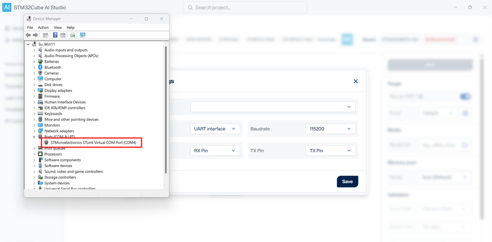

I’m having an issue connecting my STM32N6570-DK board to STM32Cube.AI Studio.
The board is detected correctly by my computer, and I can see the COM port in Windows Device Manager. However, when I open STM32Cube.AI Studio and go to Board Settings, the COM port list is empty, so I cannot select the board.
Here is what I have already checked:
  • The board is connected via USB and recognized by Windows.
  • The COM port appears normally in Device Manager.
  • I set the board to DEV mode with Switch 1 = HIGH.
  • I restarted STM32Cube.AI Studio and reconnected the board.
Despite this, the COM port does not appear in the Board Settings dropdown in STM32Cube.AI Studio.
