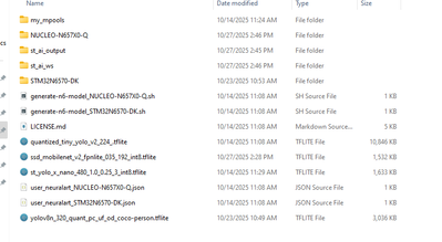

In /model of the getting started you have:
if you look at the .sh for the DK you will see this:
stedgeai generate --model st_yolo_x_nano_480_1.0_0.25_3_st_int8.tflite --target stm32n6 --st-neural-art default@user_neuralart_STM32N6570-DK.json --input-data-type uint8 --output-data-type int8
cp st_ai_output/network.c STM32N6570-DK/
cp st_ai_output/network_ecblobs.h STM32N6570-DK/
cp st_ai_output/network_atonbuf.xSPI2.raw STM32N6570-DK/network_data.xSPI2.bin
arm-none-eabi-objcopy -I binary STM32N6570-DK/network_data.xSPI2.bin --change-addresses 0x70380000 -O ihex STM32N6570-DK/network_data.hex
You can see that the generate uses the default profile of "user_neuralart_STM32N670-DK.json" which itself uses the memory description in /my_mpools.
Please try to do the generation of the file locally using the right ST Edge AI Core version (should be version 2.2) and these exact command and let me know if this helps.
