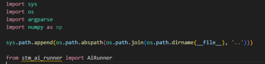

If you get an error saying that st_ai_runner module is not found, edit the checker.py like this:

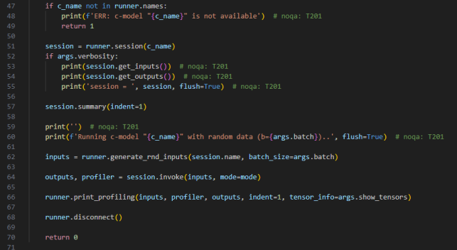

By default, the AI checker gives you information about the inference time by node (epoch). In your case, I think the example "tflite_test.py" is more interesting for you, as it provides a typical example to compare the outputs of the generated C-model against the predictions from the tf.lite.Interpreter.
I let you look at it, I will here explain how to edit the checker.py example to :
Please not that this is a preliminary version of a tutorial, so this is a bit handcrafted, we are working on more polished / automatic tutorials in the meantime.
Back to the tutorial, first open checker.py:
With that, you should now be able to create another python script or notebook, where you can:
