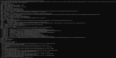

When running chain_qd or the deployment step for the STM32N6570-DK, the process fails at the “Board programming” stage.
The exception I receive is:
common.stm32ai_local.utils.STMAICToolsError: E400: Board programming failed!
At the moment of failure, res_code = -1.
From the logs it looks like all model‑related steps (conversion, code generation, project creation) succeed, and only the board programming / flashing step fails.

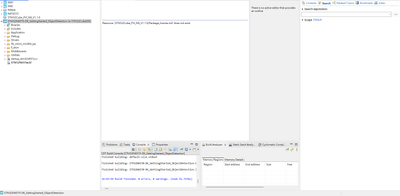

Following the suggestion there, I opened the project generated by stm32ai-modelzoo-services in STM32CubeIDE:
...\application_code\object_detection\STM32N6\Application\STM32N6570-DK\STM32CubeIDE
Then I built the project manually in STM32CubeIDE. The build completed successfully with:
0 errors, 0 warnings

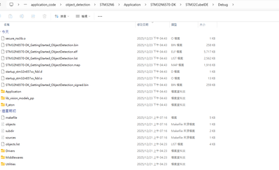

The following output files present in the Debug folder:
STM32N6570-DK_GettingStarted_ObjectDetection.elf
STM32N6570-DK_GettingStarted_ObjectDetection.bin
STM32N6570-DK_GettingStarted_ObjectDetection_signed.bin
This confirms that the generated project fits in the STM32N6570-DK memory and that the compilation / linking steps are fine. The issue I am still facing is only at the board programming stage when running the deployment chain from the model zoo (I get Board programming failed in the console).
