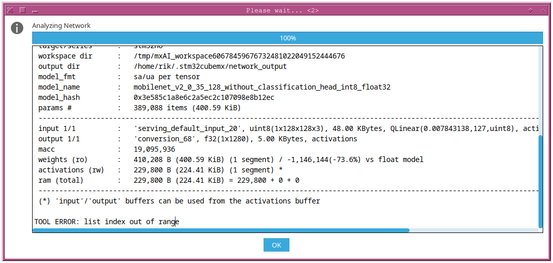

Situation 1: STM32Cube.AI MCU Runtime
When analyzing a TFLite model, it fails and shows an error message: "TOOL ERROR: List index out of range."

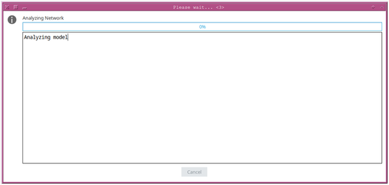

Situation 2: STM32Cube.AI Neural-ART Runtime
After clicking on the Analyze button, it's stuck at 0%. Nothing else happens, even after I wait for 30 minutes.

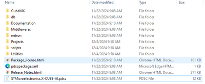

My first suggestion would be to uninstall X-CUBE-AI through STM32CubeMX, and install it again. After that, verify the content available in C:\Users\your_username\STM32Cube\Repository\Packs\STMicroelectronics\X-CUBE-AI\10.0.0.
You should have this file tree:
