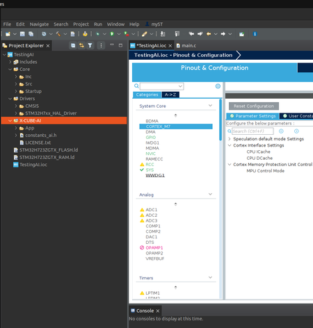

I don't have `TMPAILIB`. Here is what I have.
Screenshot from 2024-01-16 09-49-46.pngAlso, Notice that the `.ioc` is show as not saved. I did save it.
What happens is: After I save it, the options to regenerate code appear, then I click o regenerate, then after regeneration is done, the `*` is shown again in the `.ioc` tab as if I had changed the file. Then, if I try to close it, it will ask me again if I want to regenerate. Then, the loop continues.

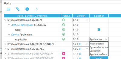

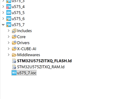

Hi, you probably don't need the answer anymore, but I found out that the middleware files are correctly generated and included if you select the application template while including the cube-ai.
So for anyone who is trying to work with versions post 5.0.0, this is how you fix your middlewares problem.
