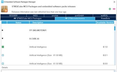

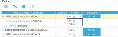

I see that v8.1 was released and I am trying to import it into STMCubeMx, but it doesn't appear to be a recognized/available package.
I manually installed it off the ST website and see it being recognized by the package manager
But, it is not available for project configuration
Is there a step I am missing here?
Thanks!
