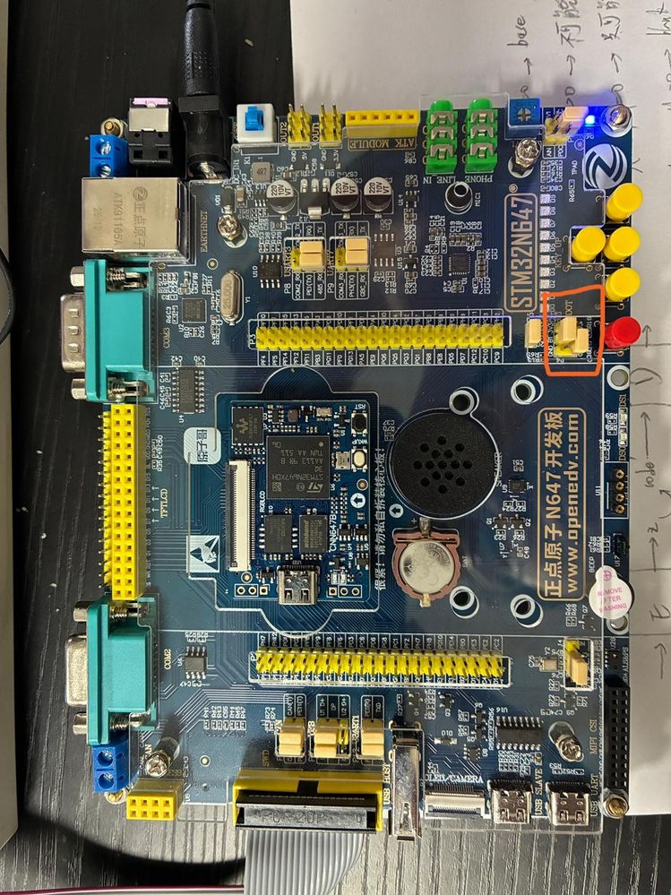

the board type is STM32N647A0H3Q, and before creating the project it's already turn on the dev mode as shown below.

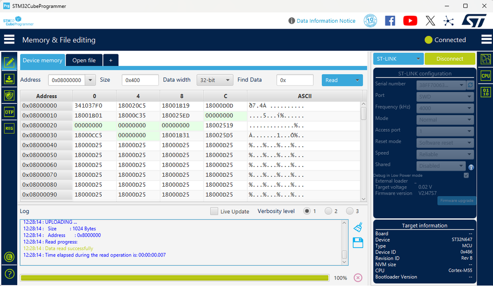

To validate ST link work with my PC, the STM32 Cube Programmer successfully connected to the board.
However, my Cube AI Studio unable to detect the board.

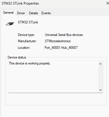

2026-03-17 9:49 PM
Following figure shows the ST link info.

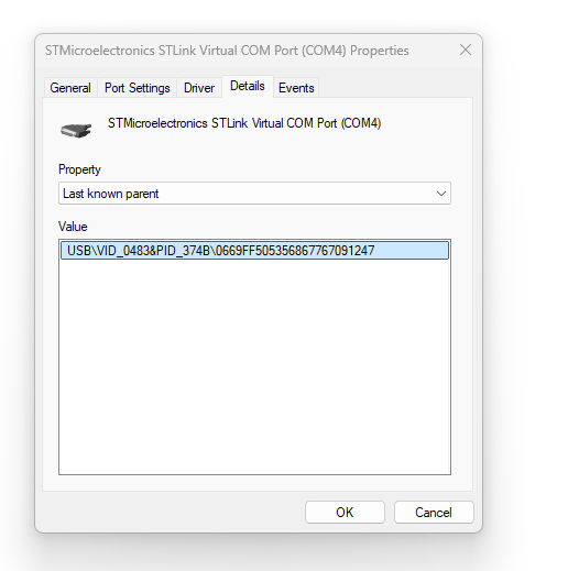

Could you please look at
- Open Device Manager
- Find your STLink VCP COM Port
- Open Properties > Properties > Details > Last Known Parent
and see if you can find the ST-Link S/N in the value ?
I will note this issue, if finding ST-Link S/N is not reliable, we should be able to fallback in another way, like performed in STM32CubeProgrammer.
