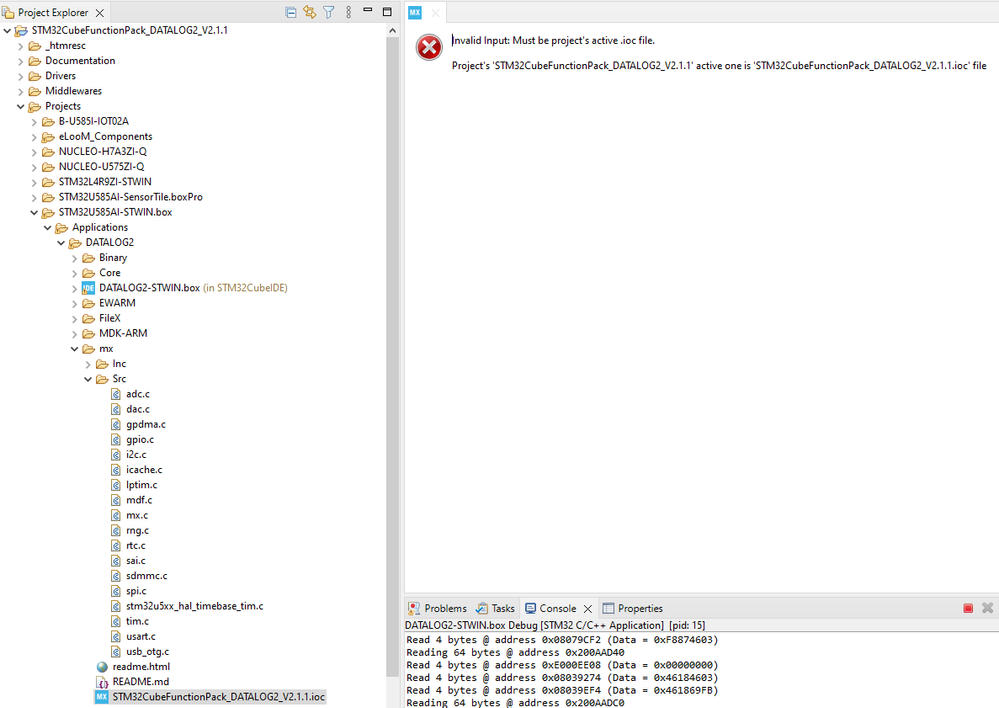

I thought that configuring an IO pin would be simple, but when try to open the ioc file I get the following error...
Invalid Input: Must be project's active .ioc file.
Project's 'STM32CubeFunctionPack_DATALOG2_V2.1.1' active one is 'STM32CubeFunctionPack_DATALOG2_V2.1.1.ioc' file
How do I resolve this ?
I managed to resolve this by using the CubeMx tool (as explained in the readme.html in the mx folder)

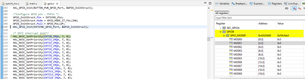

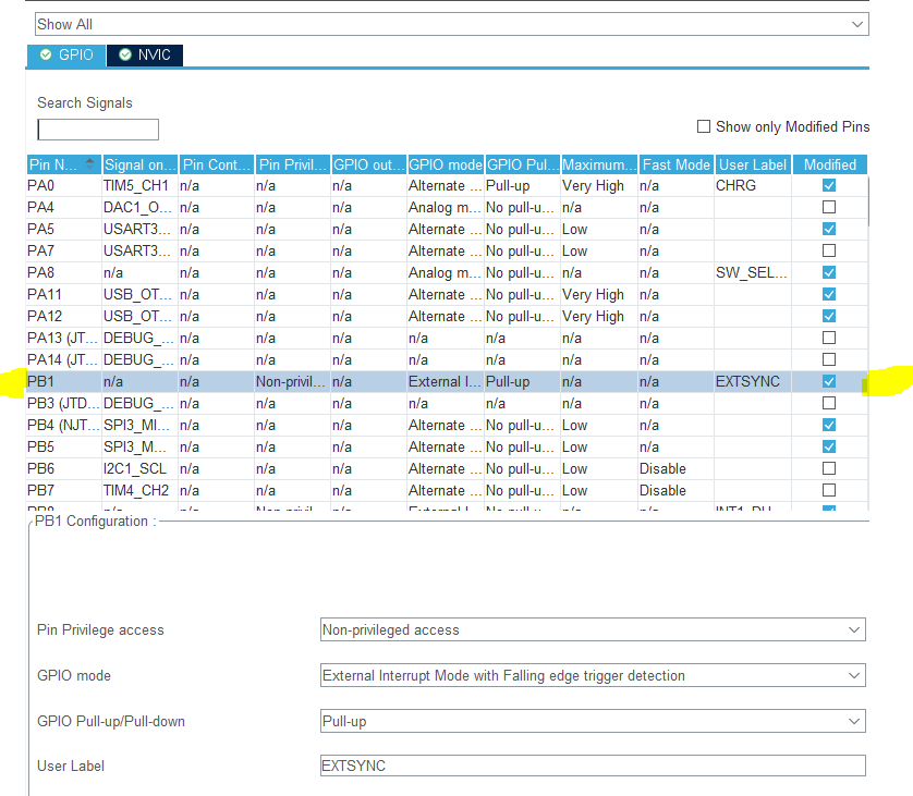

I configured pin PB1 as an external interrupt and generated the code...
In the generated code, I can see where the pin is initialised.
Where is the code for the external interrupt for this pin, or does this have to be manually implemented ?

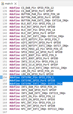

I searched the project for EXTSYNC_EXTI_IRQn but its only defined in main.h...

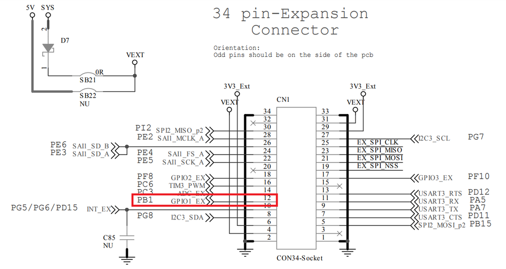

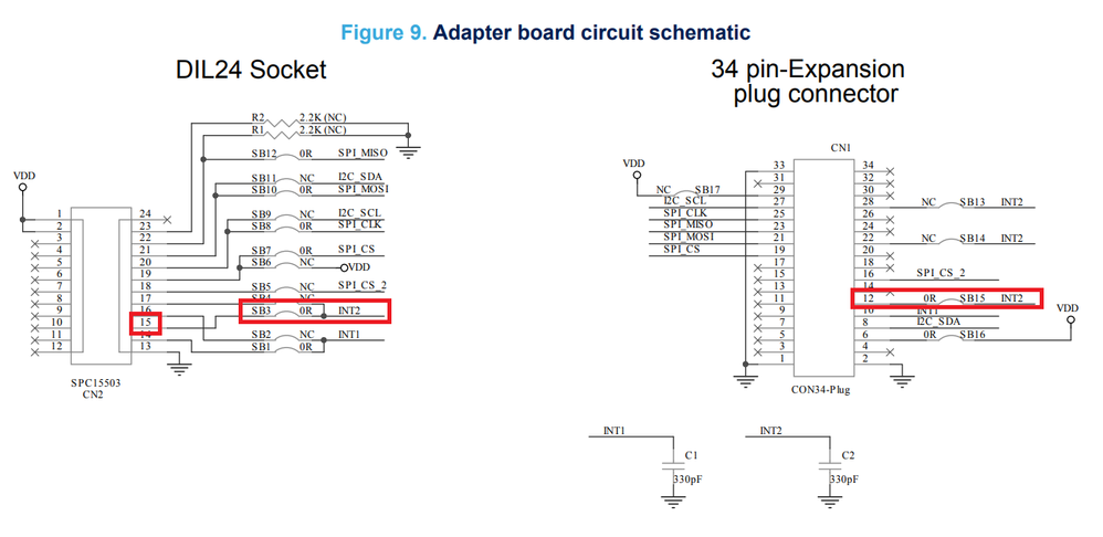

I am using PB1 which is connected to pin 12 of the CN1 connector....
PB1 (pin 12) is connected to pin 15 of the DIL24 socket on the adapter board...

When I measure the voltage of pin 15 of the DIL24 socket I expect to see 3.3V as I enabled the internal pullup resistor, however it is reading 0V.

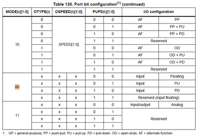

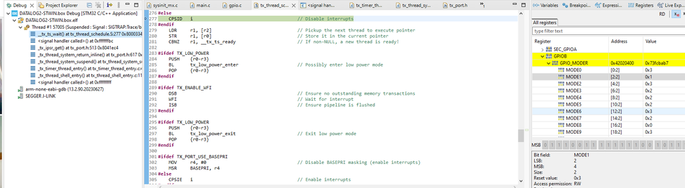

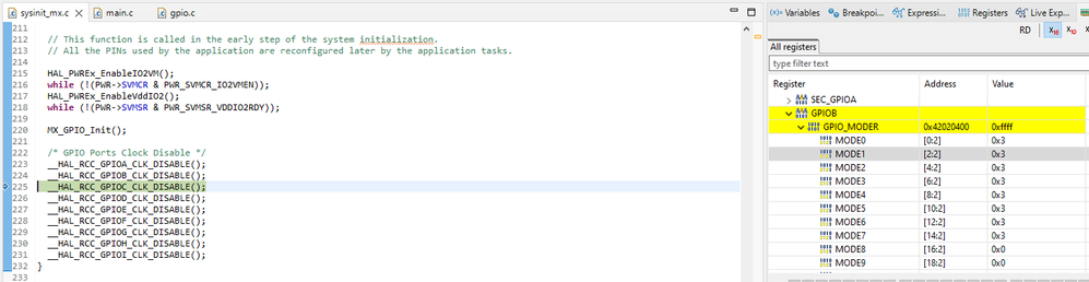

After HAL_GPIO_Init(EXTSYNC_GPIO_Port, &GPIO_InitStruct) is called, register GPIOMODER.MODE1 is 0x0 and PB1 is pulled up to 3.3V as expected....
But register GPIOMODER.MODE1 changes from 0x0 to 0x3 after __HAL_RCC_GPIOB_CLK_DISABLE() is called...
After running for a few seconds GPIOMODER.MODE1 then changes from 0x3 to 0x1...
__HAL_RCC_GPIOB_CLK_DISABLE() is intended for detaching the GPIO B route from the supply, so disabling your configuration.
I guess somewhere else the related __HAL_RCC_GPIOB_CLK_ENABLE() is invoked newly, thus enabling newly the GPIO B pins.
You have 2 choices: manually modify the code not to invoke the __HAL_RCC_GPIOB_CLK_DISABLE() anymore or move the GPIO initialization procedure you added just after the last __HAL_RCC_GPIOB_CLK_ENABLE() has been called.

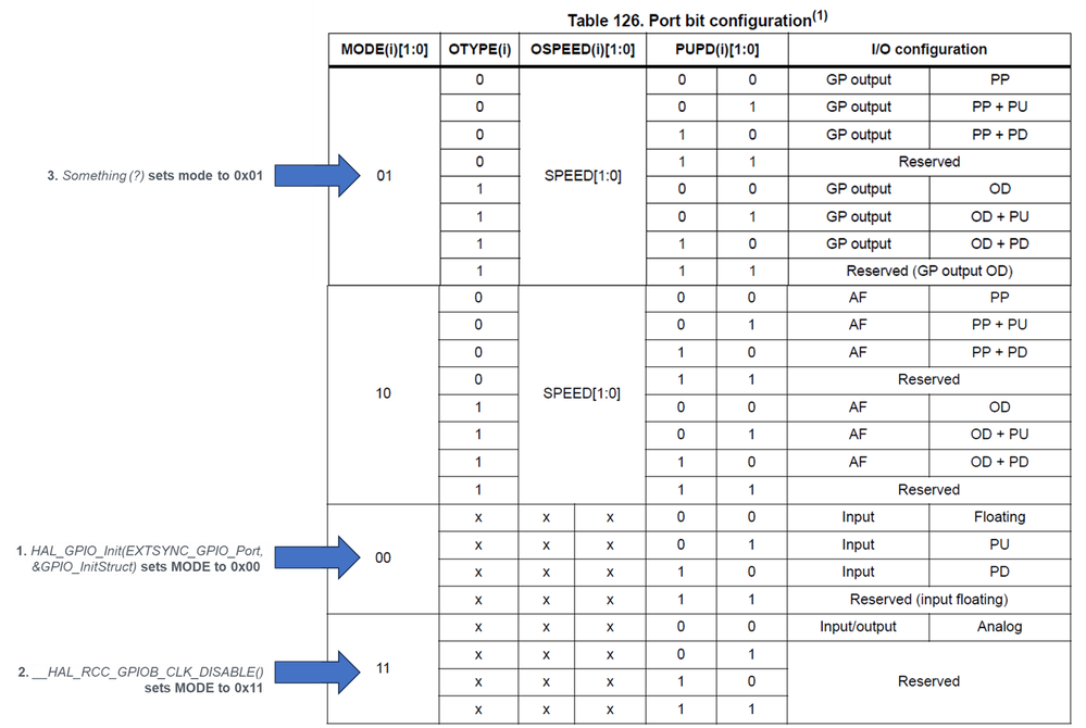

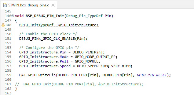

I cannot get the external hardware tag to work, because port pin PB1 is being set as a digital output i.e. GPIOB->GPIO_MODER->MODE1 = 0x1
Step 1: PB1 is initially set as a digital input i.e. GPIOB->GPIO_MODER->MODE1 = 0x0
Step 2: The clock disable then changes this to GPIOB->GPIO_MODER->MODE1 = 0x3
Step 3: Something else then sets PB1 as as digital output i.e. GPIOB->GPIO_MODER->MODE1 = 0x1
It seems something else is already using port pin PB1 and setting it to an output ?

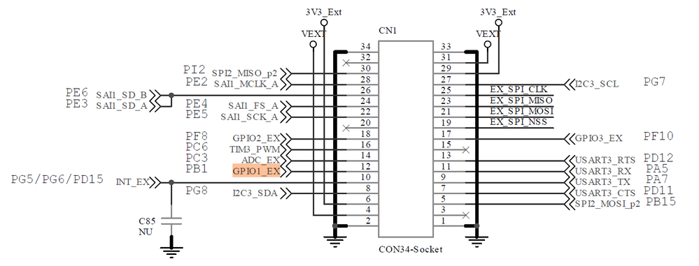

On the schematic, port pin PB1 goes to the expansion connector CN1 and has a net label GPIO1_EXT....
So is PB1 already used by something else in the software and over writing my request for it to be an input ?
I assume there something already in the software for when a sensor is connected to the expansion connector CN1  ?
Or is there a different piece of software if the expansion connector CN1 is used ?
I've found where PB1 pin is being changed, it happens during the debug pin initialization, where the code appears to initialize all the pins on the expansion connector.
So I commented out line 161 and now GPIOB->GPIO_MODER->MODE1 remains set to 0x0 (i.e. an input)....

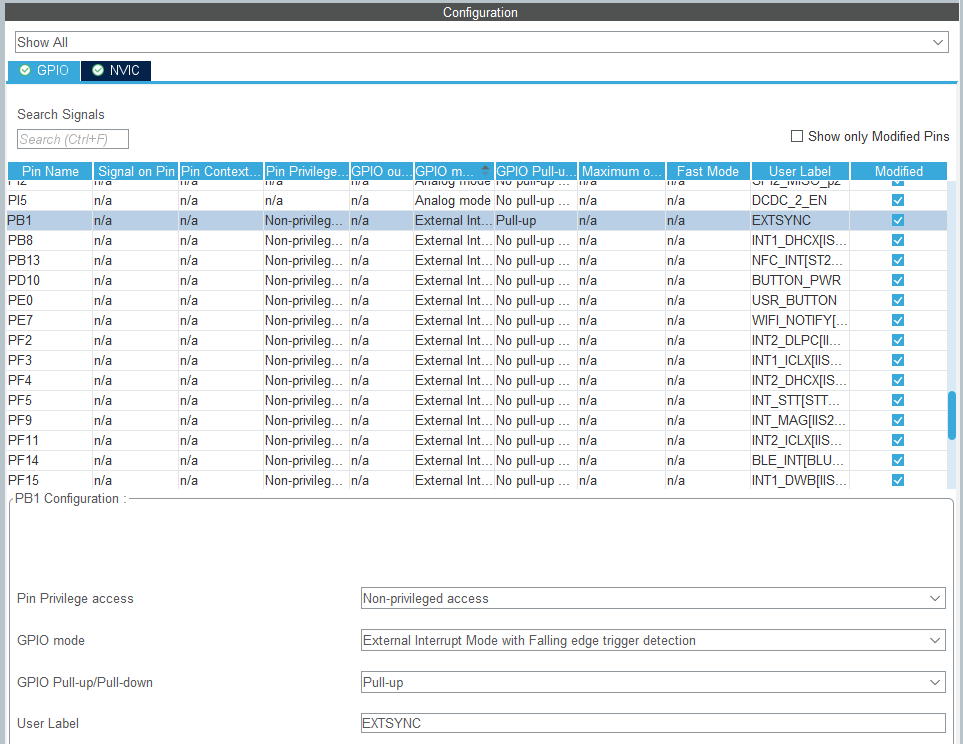

I configured PB1 in STM32 Cube MX as shown below...
But how do I find the name of the call back ?
