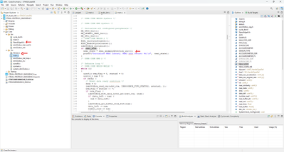

then you will find the source code for the proteus in a STM32CubeIDE project.
When opening it, you will see that the example project contains a datalogging code if the parameter NEAI_MODE is to 0 and a anomaly detection code if the parameter is set to 1.
The only thing you will need to do is replace the libneai.a and NanoEdgeAI.h with yours (that you get in the last NanoEdge step: compilation), build and run the project

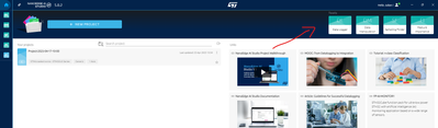

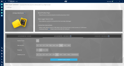

I would suggest you use the NanoEdge AI Studio datalogger generator instead:
Select the proteus and the parameters you would like to use:
It will generate a binary that you can flash as you did with the other one.

2025-04-28 1:29 AM
Hello @umitliguler ,
You can 100% replicate this video with the PROTEUS.
Later, if you want to create a simple application as it is done in the video.
Start from the source code in the repository I sent.
Make sure to clone the repository using the command in the description:
git clone https://github.com/stm32-hotspot/stm32ai-nanoedge-datalogger --recurse-submodules
